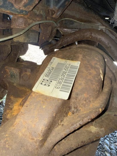

I found the sticker on top of the front axle housing and the tag in the front (though hard to read). I think that number is: 52098819 with 54 610637?

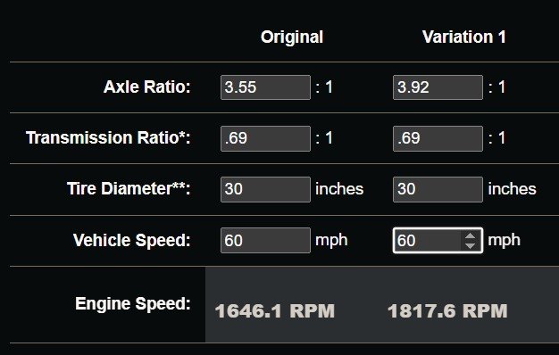

Another method of verification of axle ratio would be to use an online calculator.
Search for the transmission gear ratio specs, wheel diameter, and plug in all the numbers.
The results will indicate the RPM at a given speed.

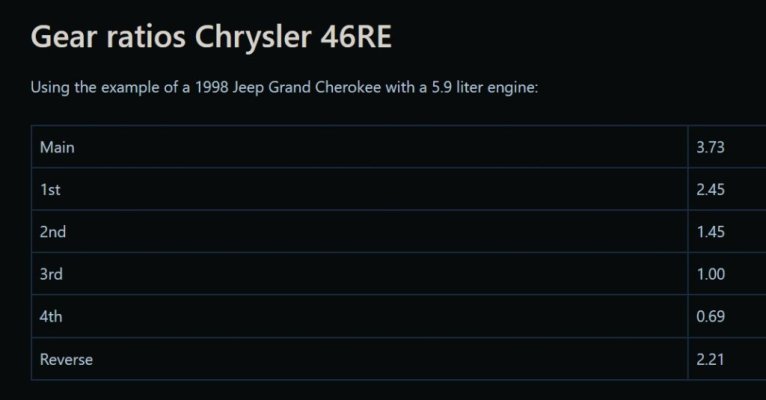

I plugged in a few arbitrary numbers for the 2 gear ratios in question.
The difference is about 170 RPM.
