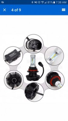

Think i found it. Looks similar to the kit i had for awhile.
The connector seating i was talking about, is not the one thing to the bulb. The truck harness to control box connectors up at the top of this pic are what i meant. They don't seat well.
Also, did you get a 9004 kit or 9007 kit?

looks like you might have ordered the wrong lights for the low beams. this is why the highs are also on

^^yep. Need to start there. That kit will work fine for your high beams but unless you repin the connector pictured above to 9007 it won't work for your lows

Sorry no I got the 9007 kit I just got that link off that website for quick reference. But I definitely ordered the 9007 for the low beams
