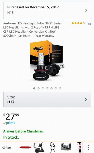

I bought these headlights and I installed them. The low beam works fine when the truck is off, but when the truck is turned on the low beams flash like 2 or 3 times and then do not work. I do however still have high beams. Could the daytime running lights cause this? 2708ab85bddbd2b25e75a4a2341a7ab0.jpg

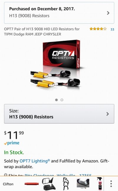

You need capacitors and resistors to work with the CANBUS and not get a bulb out error

Ballast is for HIDs, LEDs need a driver and sometimes resistors, caps and relays.

so I bought the caps off ebay do I need resistors too or does that do it all.

I figured caps would provide enough resistance to run them also due to there drain but we will see its been to cold to pull my stuff apart atm and my truck wont fit in dads garage.

UPDATE: Got the resistors in the mail today, installed them and it works like a charm. Now just got to mount the resistors to something

glad you figured it out man, one of the LED sets i tried worked without any add-on things but would randomly blink at odd times, it was crazy, it sucks how picky these trucks are when it comes to lights, but yeah pretty much anything other than stock will require some form of extra to make it work
