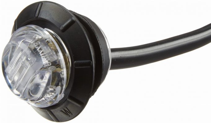

I want to put some clearance led in my runnning board. I already done that twice, but the led won't last more than few hour.
There is a place that I could hook up the + wire and and where I can put the ground ?
The first try I connected them to a switched 12v cigar plug. Maybe the ground was not so good ?
Also we have hard winter here, so I need to protect every connection from the salt and calcium they put on road. I have the plug for the trailer, but I don't want to splice the wire because the calcium may damage it.
Maybe someone here have installed some led on their truck and have the tricks to plug them with parking light.
Thank you !
that's the type of led I use 3/4" 710JW2ldpVL._SL1500_.jpg

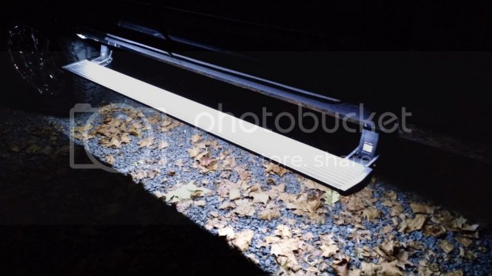

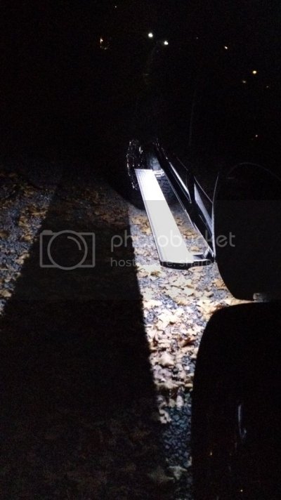

Before I installed my lighted AMP Powersteps, I installed Rigid A Series under the truck. Plenty of light now.
Light mounted to frame, two per side:
Just the A series with retracted running boards, pardon the filthy truck...the roads are nothing but slush and mud here now:
The Rigid A's and the rocker mounted LED's that come with the AMP Power steps;

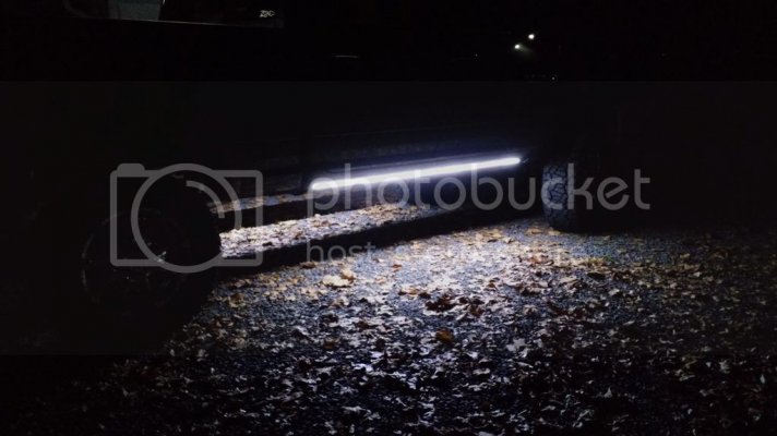

i have waterproof led strips running the length of my cabs pinch weld and tied into my amp research powersteps existing connectors waiting to see how it handles the winter weather as i installed it this summer but they have no issue with water IMG_0271.jpg

Wow ! That's bright

I have waterproof led strips running the length of my cabs pinch weld and tied into my amp research powersteps existing connectors.
I've done the same thing with mine.
If you miss the step at night, you must be blind.
I know thanks 2robinhood for the awesome idea I tried it after seeing your post a while back here on the forum its a great mod :)
