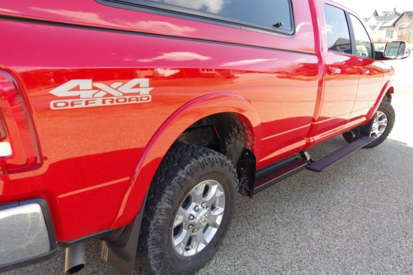

I have factory that came on my Laramie. Love them and not having to plug into the Obd port etc as well as integration the the uconnect is wotlrth the extra. I hit deploy so both boards are out when I park. They definitley stop the doors of other cars from being able to hit my body work. Some pickups are tall enough for their doors to miss the boards, but not many. I also have box boards that are permanent.
