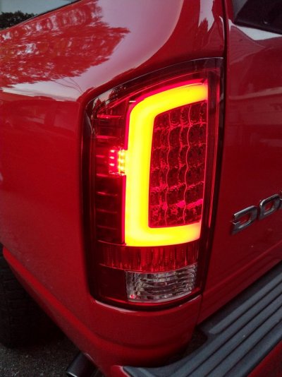

I just went with whole compatible units when I finally found a set that wasn't garish:

Where did you get those? There are some similar on Amazon but they are not as nice.

I haven't had a problem with them in the 3 yrs I've had them and it's been absolutely wonderful to not ever put up with the intermittent 'lamp out' ding the entire time. I just hope they haven't changed anything in that time; mine are great.

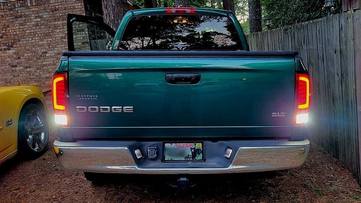

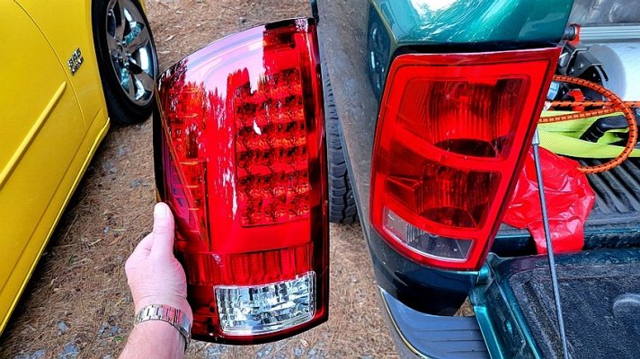

Got my new LED tail lights install yesterday evening. Here are some photos. Note that the "neon-looking" parts actually appear red. For some reason, my cell phone camera makes them seem orange.
I used Auxito brand LED bulbs for the reverse lights. These are about $20 a pair. But they look and work great:
Before (Original 2003 OEM tail lights):
After:
Brake and signal lights:
Reverse lights:

They stand out so much more on a different color, looks good.
