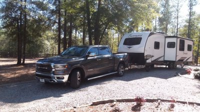

Mostly it towed great. Twice, on some uneven road, it got into a bit of sway. The truck had some rolling, and the trailer was fishtailing a bit. Happened at about 60, or so, and slowing way down stopped it.
There are a lot of new things here for me. Air suspension on the truck. WDH with a friction sway control, and not really knowing the tongue weight as a percentage of trailer weight. Previously I’ve towed slightly lighter TTs with SUVs and Ram 3500. Never once got a sway-instability in the past. And never had a anti-sway friction device before, either.
Since the trip I read another thread here about anti-roll, or sway bars for the rear of the truck yielding improvements.
I’m thinking that the sway bar for the truck may be a good thing, as I could easily induce the sway-fishtail with the gentlest back n forth motion on the steering wheel.
