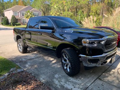

An easy way to level an air suspension truck is using the adjustable ride height links, such as this kit...
https://www.revelperformance.com/lifts/2019-ram-adjustable-air-leveling-links-set-of-four-links/
Here is a pic of one using the setup with 285/55/22 ridge grapplers...

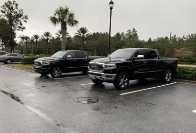

And a comparison pic to a stock truck...
Did you use the day star pucks?
how much overall did the truck raise, or did you raise the entire truck not just level?
olyelr
Nov 18, 2018
5,531
4,549
Kewadin MI
Its not my truck, I dont know for sure. I snagged those pics off of revels website.
They are 285/55/22 ridge grapplers tho.
