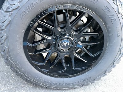

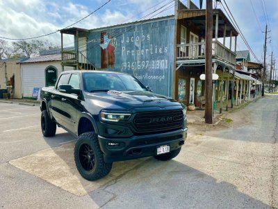

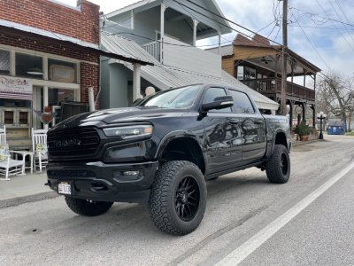

I bought a 2020 ram Limited. The Air suspension is the only suspension option you have with that vehicle. I also got the night edition and I absolutely loved it. Initially I put NItto Ridge Grappler 305/45/22 on the original limited wheels. They looked pretty good but I wanted to lift the truck and put a 35 inch tire on there so I put a BDS 4 inch lift kit that is specifically made for the air ride suspension on. Then I chose 20 inch motiv off-road Magnus wheels in Black wrapped in 35 inch BF Goodrich KO2s. The lift kit was just over $2600 the installation of that kit by a local shop was $1400. The tire and wheel set up cost me $2900. I then sold my stock wheels with the metal ridge grappler tires on them for $2000. So I’m all in for about $4900. I cannot tell you how great the ride is now. The ram already had a terrific ride but now it’s even better! A week after I had the lift kit done me and my wife drove to Texas from Long Island New York. The 3700 mile round trip was an absolute pleasure. When I get my next truck I am going to do the same exact thing

Great lookin’ setup!
But...holy frikin’ wheel weights batman!!!
