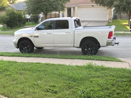

I bought my truck last April. Leveled it within a month or so, and it’s already lifted. 9b31b5a6e8db2d3f82a7e9ab616d9f58.jpg

Would love to do this
Thanks! I did all the work myself. I didn’t want to pay a shop several hundred if I could do it myself. Everything that’s been done has been in the driveway. Also take more pride in how my truck looks because of it.
