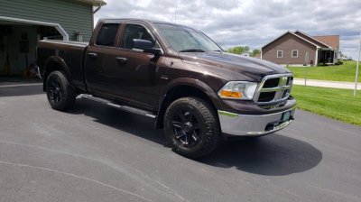

I had the HBS 2" spacers on mine for about 5 years with nothing else and no problems whatsoever.
Last year I redid everything with Bilsteins at 2.8, upper control arms. diff drop, and body lift. still rides great
first pic with HBS 2 spacers and 33's
