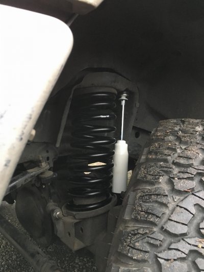

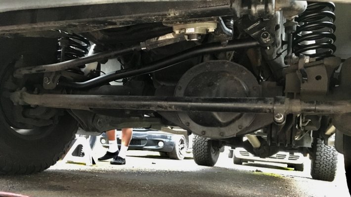

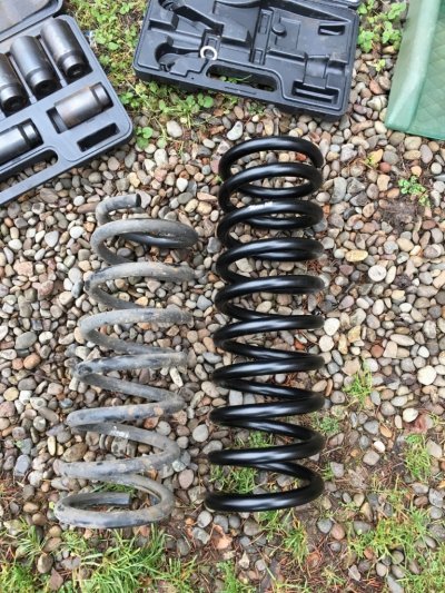

9fe9f2b8dc385e4f10eb891aadd09110.jpgb397773d337da8152e3eef0f9a67e564.jpg8ef98ac0204797c4a733c6df0128ba70.jpg5ec4032ea75fd27c778680817549a010.jpg13ec01118448ee9ce784d247b9d06756.jpg216f87086a06420db7e701c5f788d2ed.jpg7bf9f39fedbada58113eabe9a9779b9a.jpg
Thuren leveling kit is amazing. Longer coils with softer spring rate give you 2 1/2" of lift, a softer ride, and more suspension travel. The Overland shocks with the kit are valved for the softer spring rate. The HD adjustable track bar re-centers your axle after install and is much stronger than stock. Recommend it to anyone looking to level their Ram 2500/3500 the right way [emoji1417]
