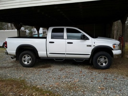

Recently bought a 07 2500 4wd and the rear is really high compared to the front. Looking at the rear spring pack I see 5 spacers above the spring pack. By spacers I mean they are the thickness of a heavy spring but just the length of the perch. I'll assume this is all stock. I'm planning to take 4 of the spacers out. Unfortunately the U bolts don't have enough threads to pull it back together and I'll need new U bolts. Anyone who has done this has input I would appreciate reading them.
Above or below the spring pack? Those spacers should be between the axle and the spring pack if stock.
Just move the spacers from the bottom of the spring pack to the top, then you can re-use the u-bolts. It's pretty common way of doing a reverse level.
Moving the spacers and removing the overload will make the truck pretty level, very close to how level my truck was with 2" coils up front.

Haha that is an excellent idea... Thanks,,

Went to the shop and put on two new front tires and measured it on a flat floor and the rear is 3/4 of an inch higher than the front. I'm going to leave it as is. Drives better with the new tires.
