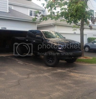

Just another leveled and body lift setup. I have 5100's at 2.8", 1.75" rear coil spacers, and 3" PA body lift. Riding on LT325/60R20 Terra Grapplers (35" tire).
On a side note, pick your level wisely on a 2014. Lots of guys having issues with ball joints popping. Some are replacing upper control arms just to prevent this issue.
