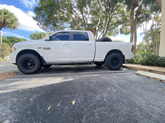

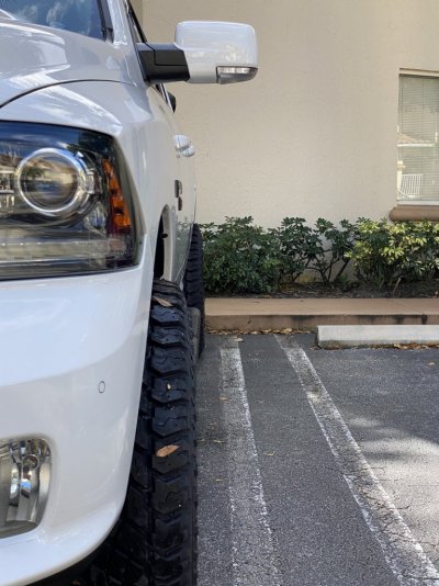

Lift is finally "done"
- Eibach pro truck lift with rings at 2nd slot
- RC 1/2" top plate spacers in the front
- Zone UCAs
- 315/70r17 cooper discoverer st maxx
- 17x9 procomp 32 wheels with -6mm offset
- lug nuts and 77.8 to 108 mm hub centric rings
I have a zone 1.5" body lift I may still be installing at some point when I can get a long weekend I dont need to drive since this is my only vehicle
After the lift was installed I was on stock tires for about a week and fender measurements on stock tires were ~36/40 inches F/R before and 39.5/41.5 F/R after. Havent measured with new tires on yet
Note- front wheel is slightly turned from backing in so it may look "off" in the pics

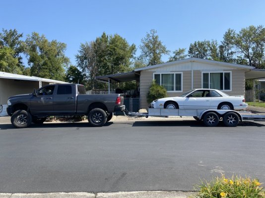

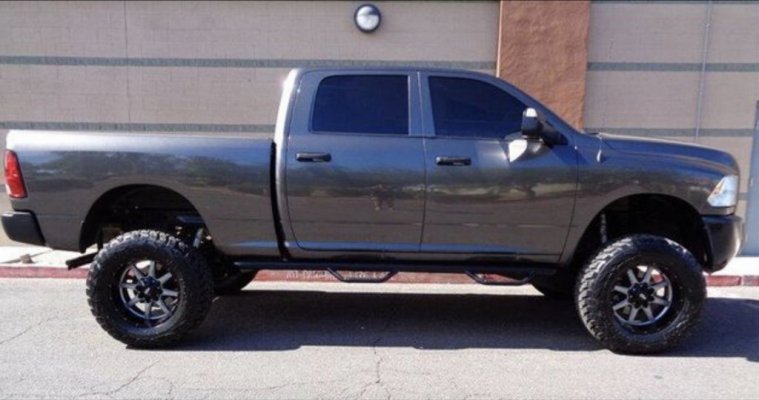

2016 2500 6.4 4x4 with 4.10 gears on a 5 1/2” BDS Radius arm lift with fox shocks. Full Badge and chrome delete, 10 % tint front and over factory rear windows, 50% full windshield tint with 5% curved brow. 6500k HID headlights and full LED swap throughout. Moto metal M0970 20x10 -24 wheels currently wrapped in a 37/13.50 Maxxis Razr MT, K&N CAI, magnaflow muffler with resonator delete and dumped 5” tip kept high and tight so it’s unseen at rear axle.
