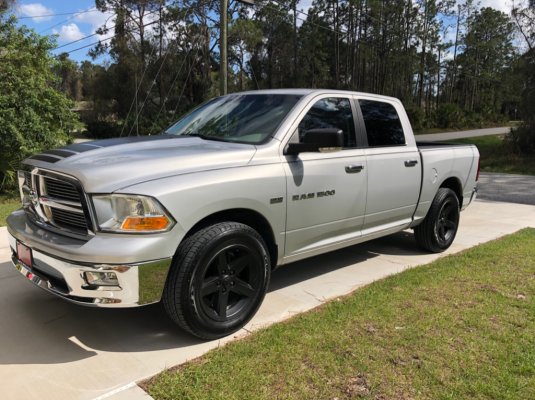

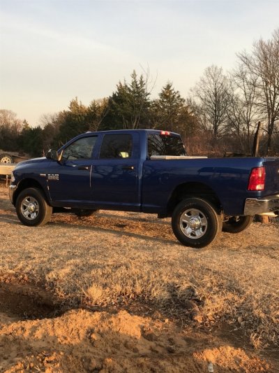

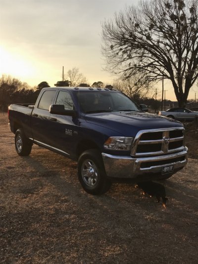

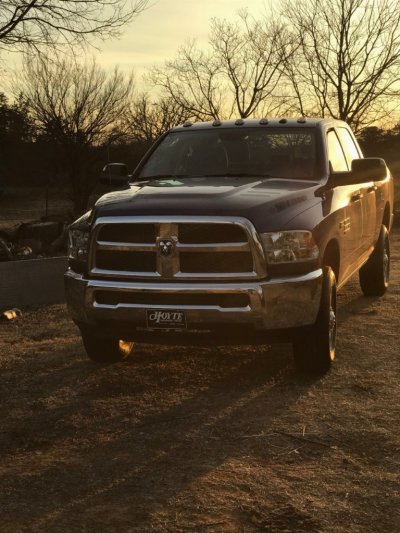

Trying to figure out what lift to put on. Any suggestions? thinking about a 4-6” lift

Go 6... you'll regret it if you dont, and the truck will still be usable.

Definitely figure out why you are considering either first and make your decision from there. Weigh the pros and cons as they fit you. The lift is one of those mods you don't want to go wrong on the first time around.

Most of the guys with the 4” lifts have added Bilsteins cranked up to get approx 6” front lift. With a 6” lift you don’t need Bilsteins cranked up to get 6”.
If your on the fence and think 6” is too much, just get the Zone or BDS 6” kit with 3” rear coils, leave out the 5/8” strut preload spacer and run factory struts. This will give you about 5” front lift, smooth ride, flat CV angles and you won’t need $200 Bilsteins or new UCA’s

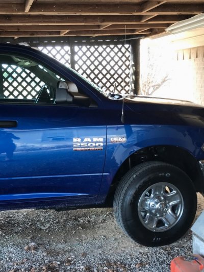

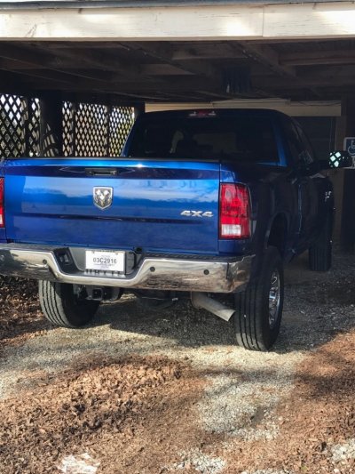

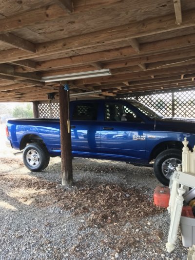

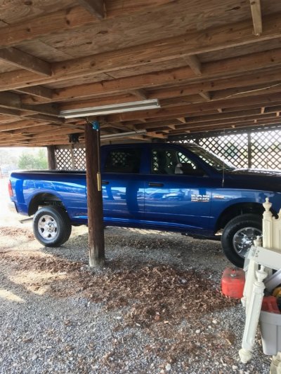

Nice truck ... Ceiling too low ... How ya gonna lift that big boy ?
Thanks, New carport on order. I’m just glad it cleared it
