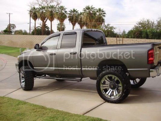

check out xill truck 07 QCSB 11" lift, 38x14 kumhos, 24x11 monsters.
I know they are huge but it looks cool.

thats a badd ass truck , dan you done dickin around ..... noticed you have been gone you must be doing something
