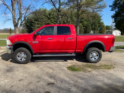

I just lifted and leveled mine, 2018 2500 4x4. The kit I bought was spacers and front shock extenders +2.5" for the front and +2" rear. 3-4 hour install, fairly easy. And hard to beat for roughly $160-$170ish I think. Parts were better quality than I expected. Rides almost the same, just higher. I'm happy with the results. Supreme Suspension was the company I went with.

On the drivers side the abs module is above the spring tower making tough to get hardware in there. Not saying it’s not possible but I don’t see why you have use anything at all since it can’t come out with the pressure of the spring. You can get one bolt to hold it up but I don’t see that it is necessary. Some kits don’t require it at all.

Since I've seen some kits with no hardware for the spacers, and the rear spacers came with no hardware, I just decided to not install the hardware on the front and see what it does. Its been a few weeks. I haven't noticed any funny noises or cars dodging parts in the rear view mirror, so I think I'm good for now. When I eventually replace the shocks with longer shocks, I'll probably add something to secure the spacer in place.
