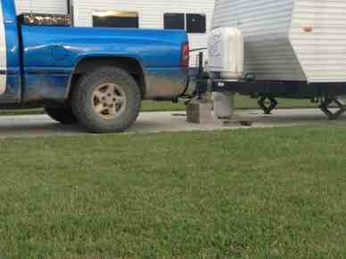

As of right now I've got 3/4 ton leafs helpers on the rear. It did lift the truck up some I also have 3/4 coil over Monroe sensa-tracs on the rear ImageUploadedByTapatalk1352339644.317261.jpg
Look closely and you will see my truck is full supporting the trailer 32' only sagged maybe 2 inch

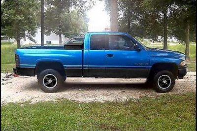

This is the truck as he sits today with te rear higher in the back . ImageUploadedByTapatalk1352339987.542106.jpg

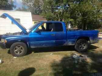

This is what my truck will look like when in done with her ImageUploadedByTapatalk1352340019.722050.jpgplus a head ache rack and some can lights
