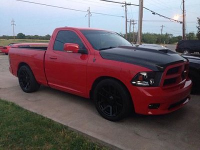

Hello guys, I recently came across a 2011 R/T for sale with 31K miles. Has about every bolt on possible... List of mods
Ripp Supercharger kit with a Vortec v3 supercharger
Intertia Motorsports Spartan Eagle Custom Blower Cam
Flowmaster muffler into 2 5'' exhaust tips
Performance 545 rfe built transmission
Dyno Tuned
American racing long tube headers
87mm Ported Throttle body Auto Meter Boost and Air Fuel Ratio Gauges
bell tech sport suspension, and lowered 2/4 beltech drop
Its tuned for 5lbs of boost. Putting out 451hp and 480tq
I really like the truck. But my big worry is the transmission. This truck would be my daily driver, and cant afford to have it go down. Seems like every boosted ram on here has eaten through a built trans.... Truck is in Texas and im in Ohio so cant even test drive it... Thoughts guys?

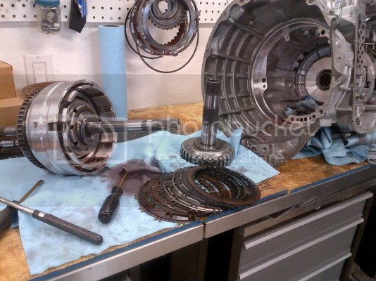

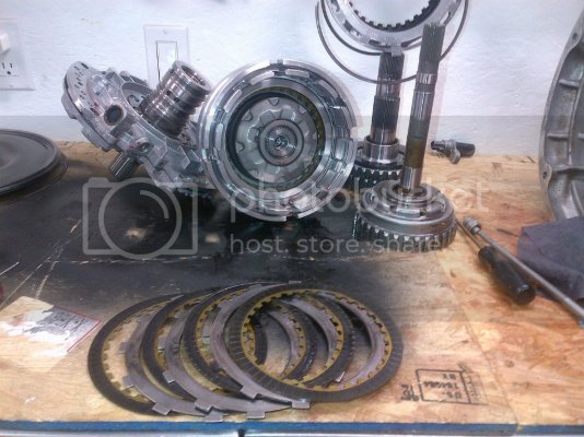

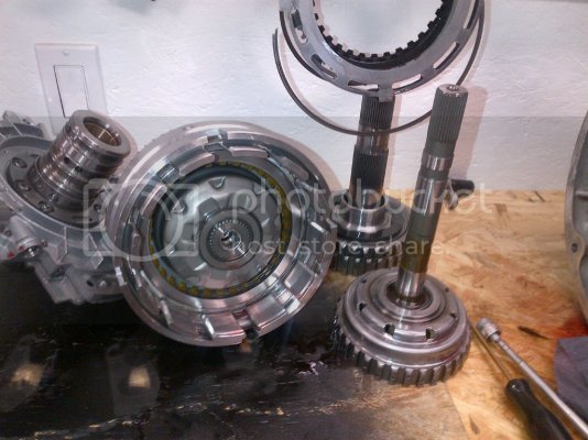

the 45RFE was the first ****, a four speed auto
originally designed to go behind a 4.7L Jeep Grand Cherokee in 99'
(rated at a mere 235HP/295ft.lbs Torque)
When Dodge brought the Hemi back in the 3G 03' Ram
they used a reprogrammed 45RFE with a second OD gear and called it a 545RFE
Same **** with a new name, but behind a 345HP/375ft.lb Torque powerplant.
Then when Ram upgraded to the Eagle Hemi in 09' 4G
it was pushing 390HP/404ft.lb Torque and the poor 545RFE was near its breaking point.
So they slapped a pile of torque management into the programming to help protect it,
but all that did was slow throttle response, slow the shift procedure down
and increasing wear on the frictions in the already weak OD clutch pack.
in 2012, instead of finally giving us a replacement to the 13 y/o ****,
they reprogrammed it, yet again, by adding another gear by calling the 2nd prime
aka kick down gear, from the 5 speed the "new" 3rd gear and called it the 65RFE.
Finally we got a decent upgrade in 2013, the German designed ZF 8 Speed.
Aftermarket builders of the 545RFE's are currently removing the weakest clutch pack,
the OD with 3 steels/4 frictions and cramming in 14 single sided 68RFE (Ram Diesel transmission) OD frictions by machining the basket and backing plates.
It's still not enough, you also need a shift kit, modify the pump and valve body for higher line pressures
and last but most importantly you need the tune to command those higher line pressures for more holding power to keep the frictions from slipping.
Without the tune, you can still easily burn up a built trans,
ask me how I know....the hard way. 5 Times between my buddy and I.
Burned up stock OD frictions
68RFE frictions (new)
Burned up and coned from excessive heat 68RFE frictions
45RFE teardown video: https://www.youtube.com/watch?v=wIeWHqO27TA
I've done this 6 times in 12 months, its not hard but it ain't much fun anymore
if you have to pay someone to do it, you need deep pockets!
