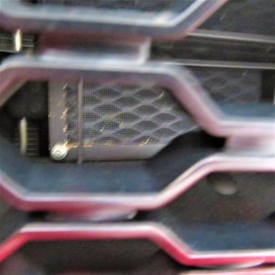

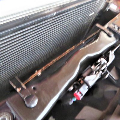

I used to build a bug screen that bolted into the bottom bolts of the rad support,and then used push pins to hold it in place at the top. I gave the pattern to a welder,but he lost them.I quit building them,as i didn't even break even on them. They had basically 2 frames,one bolted to the other,so i could remove it if i ever needed to replace the screen,the main frame had expanded metal welded into it. The one on my truck needs a repaint as it's 11 years old now,and has been on 2 trucks,it was the original prototype from my old 13.They fit trucks with or with-out the shutters,my 13 never had shutters,but the 14 did
