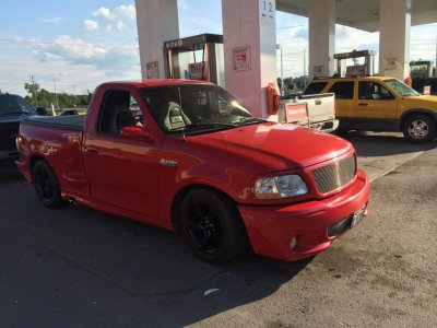

Yup me and a buddy of mine with a ford lightning made the 6 hour round trip last night and we only got time for 2 runs each by time we got there lol.
Anyways here's my slips from last night I was number 854. First pass is on the left second run is on the right.
Truck ran good and hooked up not bad. Got a small bit of a chirp out of the tires but then they just hooked up and went good. Overall I'm pretty happy with the times especially since that was at full street weight on my heavy ass 20's with the hard tonneau cover still on.
Weather couldn't have been much better either. Air cooled right down but the track was still good for traction.
My buddies lightning also ran great last night. This was the first time he got to run it on his slicks and he ran a 13.79 then a 13.77
Overall was a very long but good night. Was almost 3:30 this morning when I finally got home lol we already made a deal that we'd plan our next trip a lot better and take a half a day off work so we can be there by 6 or so we can let the trucks actually cool down and be ready to go right at 7 when they start the test and tune.
