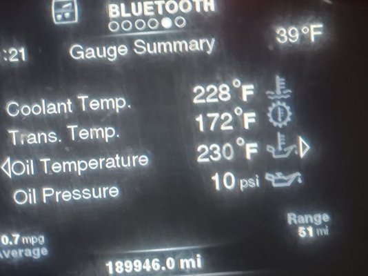

Low oil pressure at idel

Used to be 1 psi per 100 rpm is sufficient
Provided your idling at 800 rpm, minimum should be 8psi, and you're seeing 10
What happens when you blip the throttle to say, 1200?

Definitely if U do not so, betta oil and filter. I also see U got almost 190,000 on the odometer. Could be other things or just a bad switch/sensor also.
