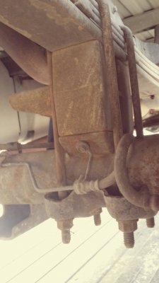

I have a 2002 dodge ram 2500 4x4 5.9L gas that has been lifted 4". I have heard horror storys on putting a cabover camper on the back of these. So I want to lower the truck to not worry about cabover camper on it. I do not know what lift kit was installed. I know I will need new coil springs and U bolts for the back end, but do I need to replace the leaf and or helper springs? What is the lowest I can go (as far down to stock) to not worry about putting a cabover camper on this truck? Any info will help. Thanks

The first problem I see that, to my extensive knowledge, no one makes a 4 inch lift.
The only company to make a true 4 inch lift was Trailmaster, and they discontinued it about a decade ago.
If it is a Trailmaster, it was a long arm lift and control arm mounts were torched off as part the install.
Tuff country offers a 4.5 inch lift that uses a real tall front spacer.
So before anyone will give you any advice, we'd want to see photos of what you have.
Carefully take some quality photos of the upper spring mounts, front control arms, and from under the truck, the rear leaf spring blocks.
A big concern when running a large bed camper is being top heavy and very susceptible to cross winds. If you don't have one now, I'd start looking for a rear sway bar. It will help a bunch with handling and turning.

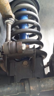

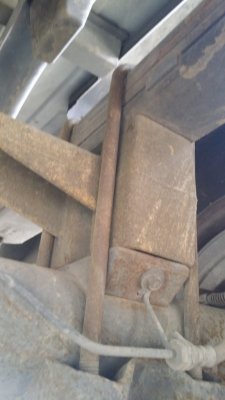

Thanks, it's raining now so will have to wait till it's over to get some pics taken. I was assuming that it is a 4" lift, thats what the person I bought the truck off of said. So it may be in fact a 4.5" Will have to check as soon as it stops raining. I do have these pics already taken, but may not be good enough20190304_160119.jpg 20190304_160327.jpg 20190304_160448.jpg 20190304_160327.jpg 20190304_160448.jpg

Well...I don't know how to break this to you, but...
The rear block you see is a factory block. Aftermarket blocks don't come with the bump stop step cast in them.
The front end doesn't have any lift spacers in it, just the rubber isolation pads under the spring. I'd bet your control arms are stock U shaped pieces of stamped steel with rubber bushings. Just what the factory installed.
It's true that 3/4 tons sit higher than 1/2 tons. Spring rates and mounting points (due to a different frame) cover some of that. But your truck doesn't have a "lift" or aftermarket suspension.
I'd recommend getting your front sway bar links replaced as they a cracked and borderline useless, and find a rear sway bar setup for your truck. I don't know how old your shocks are, but I'd recommend something heavier like gas magnums or Bilsteins.
Also, the truck is in real nice shape underneath. Must not see much salt.
