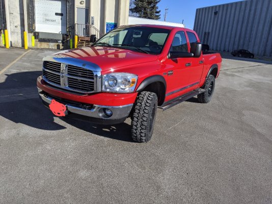

Here is a picture of the truck, only thing it has wrong with it is the stupid fake chrome peeling off a spot on the bug guard.
