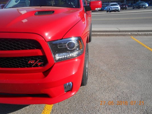

Staggered offset rims are your easiest option. I narrowed the spindles on my truck 0.600",but it takes a machine shop to narrow the spindles and caliper brackets,where as staggered rims are just a bolt on.
