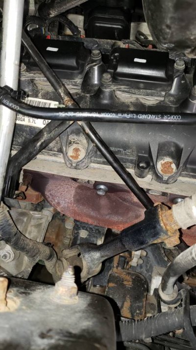

So I recently got a 2016 ram 1500 sport and last week I swapped all the manifold bolts to grade 8 hardware to avoid the dreaded broken bolt tick... lock washers and washers included. I removed heat shields and torqued up good, retorqued again just to verify. I attached my dipstick bracket to the brake booster to avoid any rattles but now and it may have been there prior to changing any bolts I've noticed a rattle with acceleration as shown in the video you can hear... everything is snug and I'm at a loss.. only during driving not in park reving or neutral
Any ideas?

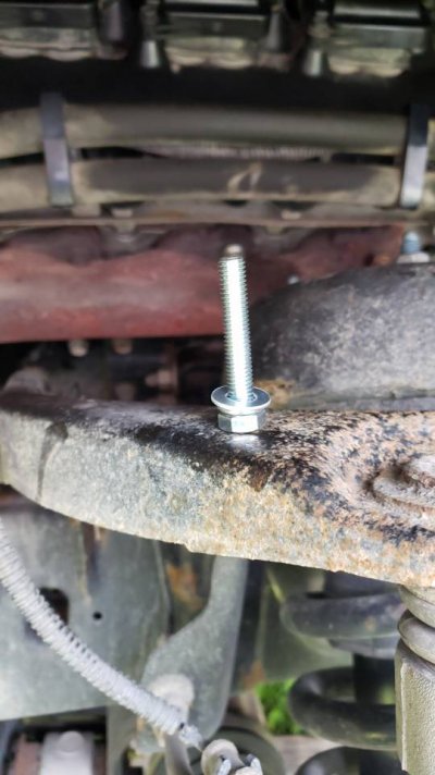

I didnt use the stage 8 ones with those tabs just regular hardware store bolts washers and lock washers as per jay greene since I just wanted to replace stock bolts with something abit better quality
I removed heat shields but I cant see that making the noise... I've read some guys say the noise comes from where y pipe meets the main pipe heading to muffler there's some tab thing as shown in pic below ...will check that tomorrowfd9f9494c9b3d8284ea79feb6494c1ff.jpg6149a30a38a7096b964de178e12303f6.jpg
