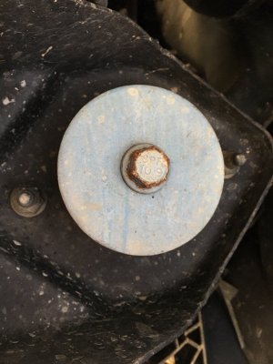

Been getting a clunk randomly and think I have it figured out. Missing a bolt with large washer from the front of the frame drivers side. I’ve included pics of both sides to illustrate what I’ve got and what I’m missing. Can someone help me ID this part do I can replace it??

Thx wasn’t sure what it was called would this be it??
6510855AA
SCREW AND WASHER, Hex Flange Head

I cant say for sure, but it looks like there is also a pretty substantial bushing on the one that is still there. Could just be the lip on the mounting surface, but usually with a washer that big, it is to compress a rubber bushing.

put the aforementioned cab mount bolt in and problem solved. It was located at the front of the frame drivers side. Thx for the help--
It looks like it might never of had that bolt,i'd of yelled at my local dealer to put one in free,lol

You’ll want to recheck the torque on the other cab bolts, since they were being stressed and working overtime.
