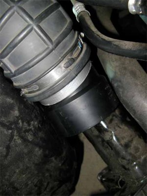

Awesome work!! Im definitely gonna try this. Money is short right now and better mpg's and throttle response sound good to me for the price of 5 bucks. Thanks for sharing.

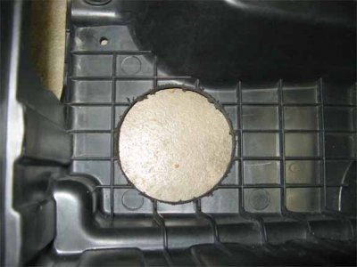

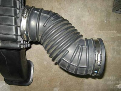

Mine is similar but the more common way is drilling the hole in the bottom of the Air Box, otherwise pretty identical. I did spend a little more because I bought an extra Air Box (used) to do this without modifying my stock parts. The extra one I bought came with an intake tube for a 4.7L or something other than the Hemi so I used that as my down-tube. Much better for heat resistance than an aluminum duct tube most folks are using. Than I used a 45º angeled PVC pipe to make a scoop. I also put in an Airaid Performance Air Filter. Personally, I did not feel a thing different or see any improvement in the MPG. Did notice a whole lot more dirt on the new filter and even small pebbles in the Air Box now. What it all means, I can't tell you. It was a lot of fun though, LOL!

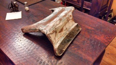

A lot here have already seen this, but I grafted a Vararam Air Grabber to fit my 03, seals against the hood and made a snorkel air intake that pulls air from the front and it removes with "Mini Push Latches" for access, the bottom air filter tray is attached with wing nuts so it pops right out as well... does this meet your qualifications for kit-bashing? I've got about 25hrs and $200 invested not including the used Vararam I picked up for $100.00.

Seen it, but its still a nice hack/kit-bash.
