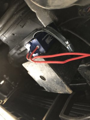

if the 1500 is set up similarly to the HD, there is what i think is a snow plow bracket mount right next to the headlight that sticks down and has some holes in it for bolts. i will be mounting mine there by running a hose clamp through those holes to prevent them from sliding down and off the bracket. it's hard to explain so i'll grab some pics when i do my install.

Heres my quick review ....
#1 complaint is having to modify stock brackets to accommodate the morimoto fogs..... I ended up breaking a tab in the process . For 250$ they should come with their own bracket already installed on the light .....
#2 I had to add a washer to allow the adjuster spring to function as it should without binding up .
#3 they should have sent self tapping screws with the lights to mount the resistors .. or metal zip ties .
I have yet to mount the resistors .... Anyone have a good spot or method to mount them? I'm all ears!
Haven't tried them at night yet so light output isn't able to be commented on yet
I got 4 stainless key rings and threaded them through the mounting holes on the resistors then zip tied them around the bumper brace as far forward as a good too avoid water splashing on them. This way the resistors aren’t touching the zip ties and the heat has some space to dissipate before reaching the plastic ties. The key rings don’t get hot to the touch so I think its working great. Other people are using 4 inch hose clamps. I didn’t have any laying around so I might do that come spring.

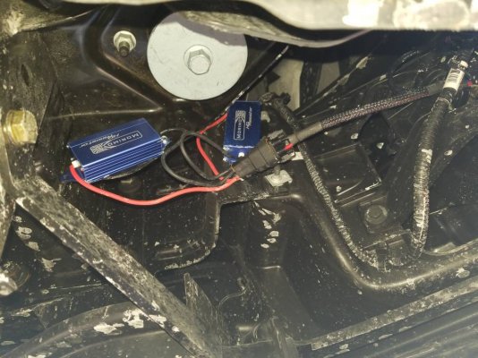

Here's where I mounted mine with self tappers. Wasn't to bad, was able to get up in there with a small dewalt impact driver and get the self tappers in.c316eea5c7bc55c4476e7319e28b76bc.jpg2a8037e1de8e4de1c8c08e986f4daff1.jpg

Copy that good idea
