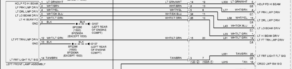

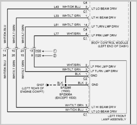

The wiring for the headlights runs from the body control module (BCM) to the headlight housing connector. There is a slight difference between the base model and the premium. The base model uses two 3-pin connectors, and the premium uses one 14-pin connector at the headlight housing.
Connector C1 of the headlight housing on the base model has both the low & high-beam wires.
The service manual is available at the link below.
