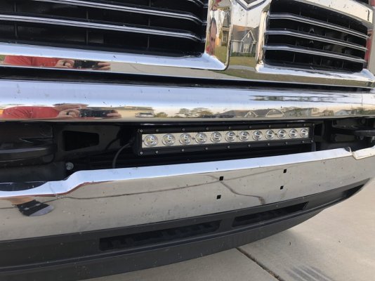

Do you mean similar to this?

"Keepemrollin14":
Nope. My 1500's bumper is solid where your light bar sits plus I'm leaning toward "pod" lights instead of a bar (the lamps will be used for on-road purposes mostly). Instead, I want to use the space currently occupied by the tow hooks once I take them off.
Thanks though! At least your photo shows the tow hooks are bolted in from the front which is of help.
Cheers,
Eric S.

Ahh ok well sorry I wasnt much of a help

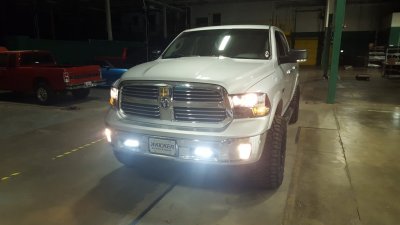

A quick update to my aux. lights post/query .... After further research and in consideration of the suggestions from those who responded (many thanks!), I purchased a pair of Rigid Industries D Series Pro ("Dually XL") driving lights and had them installed in the two tow-hook cavities. The hooks and their plastic surrounds came out very easily and the lights nicely fit the spaces. They are wired so that they can be operated with or independently of the high beams. And boy, do they light up the landscape! A bit brighter than I was expecting but better to have "more" than "less."
While I was at it, I had a pair of Rigid's "Ignite" LEDs mounted under the rear bumper adjacent to the receiver. (I had noticed the OEM reverse bulbs weren't casting a lot of light behind the RAM's rear.) These little guys throw a lot of illumination behind the truck now, and folks approaching me while I'm backing the 1500 out of the garage (I'm in a town-house complex) plainly see me and stop (at night, due to poorer street lighting and the RAM's dark colour, I don't stand out). A great safety addition! They are wired to work with or without the OEM reverse lights being on.
