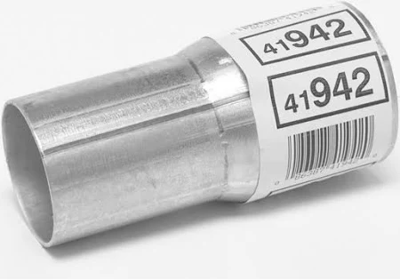

I would have been very irritated with that first patch job.
Every muffler shop has a full set of adaptors, an expansion tool & grinding tools.
View attachment 535391View attachment 535392
some shops make their own adaptors
I use my pipe expander a fair bit,and find you have to take smaller shots at expanding stainless exhaust pipe,as you can't do it all at once,like he was trying to do.
