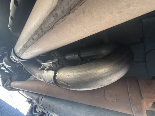

I’m not following you… the mufflex is a 1/4 wave resonator (J pipe).
Does yours look like this? (Minus the leaks and ugly lamps… I’m lazy I know)
It could certainly amplify certain frequencies (harmonics).
Yes, but traditionally they look more like a J (tap into the main exhaust pipe then follow parallel to the exhaust)
That way if you measured the length of the pipe from the end to where it connects to the main exhaust it is all relatively the same length.
Since the Mufflex pipe has an extra bend in it, you get a wider range of “lengths” (if you take the inside path vs the outside path).
That results in a wider range of frequency suppression.
To be 100% accurate in this discussion, there is a difference between a Helmholtz “chamber” and a J pipe. The J pipe works based on 1/4 wavelength, and the Helmholtz chamber operates on the volume of air in a chamber.
The buffeting in your cab when you crack just a back window open for instance driving down the highway is due to Helmholtz
Tickle me curious now! Totally get what you’re saying about the various distancs due to the radii..
