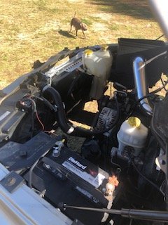

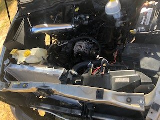

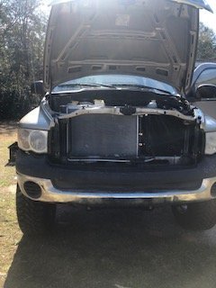

here ya go.
please excuse that positive battery cable. my fender inner liners are removed right now that's why all of the open spaces. I took them out for the alignment guy and haven't put them back in yet.
