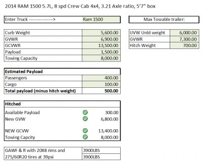

I want to set up my 1500 for towing a TT, and this is what I came up with after lurking on this forum. I appreciate any true and tried insight. The maximum TT I can tow is 7300 GVWR and 700 lbs Hitch Weight.
I’m planning to get a factory OEM brake controller, and LT tires ( I have another thread about that), and for the WDH, the best concept I saw was in the Reese 66550 Steadi-Flex hitch that uses brake pads on the bars for anti-sway. Any feedback out there on this hitch?
For the tongue weight to be around 10%, which is very important, it looks like I also need to buy a weight measurement ball to measure it each time loading the trailer, no other way?

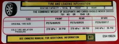

Speaking of payload, if the Tire and loading info sticker on truck shows 1546 lbs payload for the current Passanger tires, if I install LT tires the payload rating does not change? 01.jpg
MADDOG
Living in a Firepit
Dec 26, 2011
15,200
11,502
Arizona
6.4L HEMI
No, the payload rating won't change with LT tires.
You just need to make sure you have the right load rating on the tires for your planned weight.

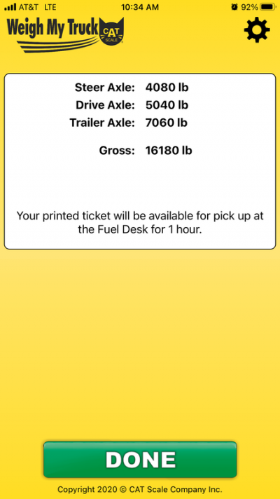

Here is his actual weigh slip from the CAT scales shortly after we left for Texas with it. This was with me and him, a bunch of his work stuff in the back seat, toolbox in the bed, etc, and a full tank of fuel. Keep in mind it says the truck was 9120lbs but about 1000lbs of that was tongue weight transferred from the TT.
The rear axle GVWR is 6500lbs and the front is 5500lbs so he was well under those limits. We did not get a weight with the bars disconnected so not sure how much transferred. We didn't actually weigh hi truck empty but my truck is identical down to every option and mine was 7240lbs with me in it and 1/2 tank of fuel. By our calculations his was about 8100lbs the day we weighed it with the TT. He had thought he lost his tool to connect the bars so we couldn't disconnect them to weigh it but we ended up finding it once we get to Texas...lol. He has the Husky TS Centerline WDH and it requires a tool to connect them. He got them connected without it but we were afraid to disconnect them on the road.
