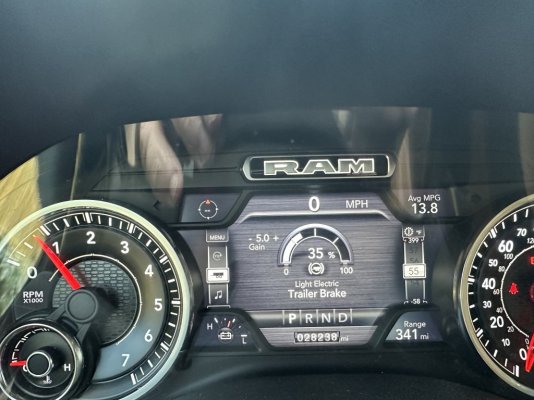

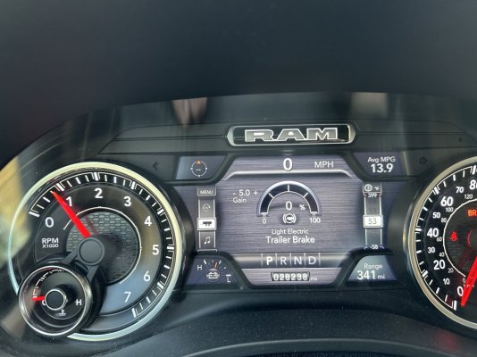

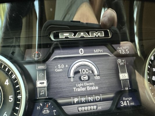

Lemme go out to my truck before I feed da hossie and take PICs fer U. Here U go OP:
CAVEAT: There is NO TRAILER attached, parked by house.
Trailer Screen "Brake" depressed
Trailer Screen Manual Slide squeezed all the way
Trailer Screen Up
(OK gotta feed critters).
Trailer Screen Brake Depressed.JPGTrailer Screen Manual Brake Slide Activated 100%.JPGTrailer.JPG

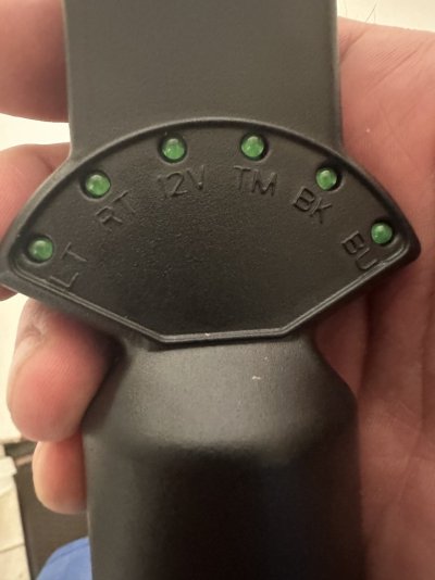

Ok so I got a tester in. Here’s the layout. Lights seem self explanatory.
Truck off I get solid 12v.
Truck running I get solid 12v and TM and I get flickering BK.
Truck running brake pressed I get solid 12v, TM, LT and RT and a mostly solid BK
I also tested BU and LT and RT separately. So it seems the wiring is swapped between BK and TM which would be brown 3 at 11 o’clock and blue 2 at 5 o’clock. If that’s confirmed my question is where is the easiest place to fix it? At the 7 pin on the back of the truck or should I go dig up my connector pin remover tools and start doing harness surgery?

OK now I'm not sure I believe the tester. On a whim I plugged in the 4 pin tester side. It also lit up the Trailer Module which is strange since the 4 pin wouldn't even be connected to the trailer module circuit on the tester. So I went through the test with my 12 volt source and it appears that the tester is miswired. Not the truck. Back to square 1.
Can’t help u there never used nor do I have. Someone else needs to chime in.
