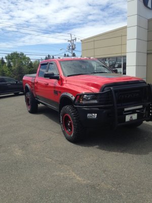

Chrisy
Military
Mar 26, 2017
149
129
Charlottetown PEI Canada
Rubbing
I had the same prob front drivers side sharp left turns only, M/T 35" Baja MTZ. I cut some of the plastic to reveal a double layer of sheet metal at the bottom close to the drivers door, I used a dead blow hammer to flatten it back then heated the plastic that stuck out like a small pocket. I used a heat gun then pressed it inward and cooled it with an ice cooled rag. No more rubbing for me now
