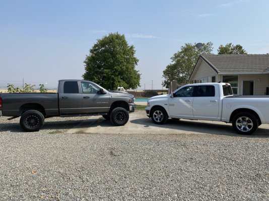

You would get more performance/mpg (back) by ditching the 6" lift and the 35's then you will get out of throwing thousands of $ at the engine...
lol well I know this! But I also use this truck to do a lot of non “on road” stuff. It goes a lot more places than my stock 2015 ram 1500. Although maybe that’s because idc if it get some scratches ;)

both my trucks. The grey one has been reduced to hauling lumber and hog feed while the white one totes around the kids
