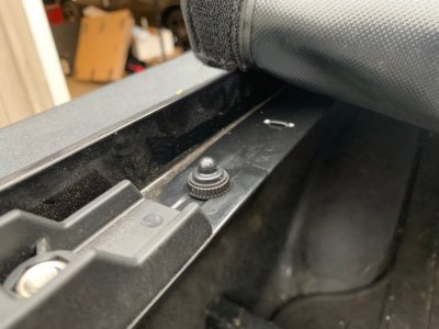

The rest of this is a bit of dual coated 20-22gauge wire that I had laying around (prob 8ft) and I put an inline fuse (5amp). I tapped into the trailer wiring battery POS+ and NEG/GROUND, ran the wires under and up the driver side bed to the switch, switch is drilled into my aluminum bed cover rail. The switch only controls 12v to the LED strip and not the ground (ground is connected right to the strip. LED strip is cut and stuck full length to side and rear bed cover rails, LED strips are cut and peeled at connection points in order to make the connections. I put dielectric grease at the connections to help with corrosion etc. I used the supplied thicker adhesive strips on the backs of connectors (bulkier than the LED strip) so it would push/pull the LED strip off the bed cover under its own weight (learned from the past). Also for the first 1-2" of each strip I added the thicker adhesive to the back of the LED strip so it would help keep it attached (learned from the past as well for falling down due to a gap). Each section is connected with 1 jumper in the same orientation, the last end on the pass tailgate side is heat shrink sealed.
Thats about it! $30 but Could be less if you only get 1 roll of LED, 1 Switch and then need to buy some wire and a fuse link. I ran RED 5050 LEDs on my last truck which worked fine but the red messed with my eyes a bit and I had trouble figuring out colors at night as the red muted/mixed them up a bit lol. The 5630 chips are brighter than the 5050 so that is something else I learned over time.

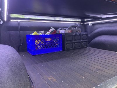

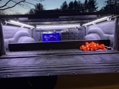

I have access to the switch with the cover locked and engaged by opening the tailgate and reaching up and pushing down on the switch (there is a gap on my cover about 1" high). LEDs are very bright as you can see and these picks are when its still daylight out.
This one was taken around 4pm so it was bright out (see tailgate daylight)
Taken later around 6pm, see sky about dusk but not fully night/dark out.
