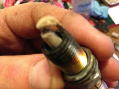

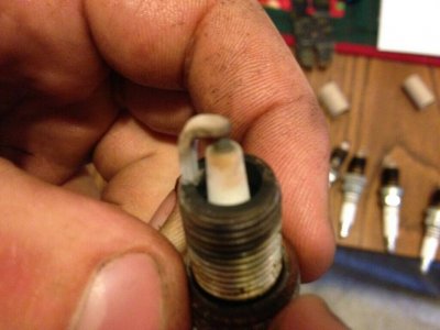

I changed my spark plugs today. The 4 towards the front were straight white with tons of carbon build up. The ones in the back were white also but had a faint tan coloring to them. Can anyone tell me why??
Sent from my MB860 using Tapatalk 2
