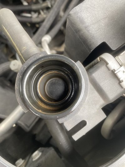

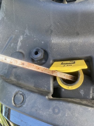

Radiator cap is how you actually check what’s in the system, the reservoir is just a reserve the system can pull from or deposit into as needed.
Mrblonde
Mrblonde
Nov 3, 2024
27
9
Brevard
Does it matter what type of coolant is used with existing coolant? Im the second owner of this 2019 ram 1500 5.7L and noticed a red color coolant in the reservoir when doing my oil change. Ive been watching YouTube videos and people have said not to mix different coolants I dont know how accurate that is. Thank you guys for any info.

Absolutely don’t mix coolants. Your 2019 should use mopar OAT 10 year/150k mile.
Is that a specialty order or should oreilly or auto zone carry it. Thanks dude I appreciate you
Mrblonde
Mrblonde
Nov 3, 2024
27
9
Brevard
The remaining coolant color is red. Does that mean its a different type?

Is there anything else that can be used besides the mopar 10 year 150k?
Mrblonde
Mrblonde
Nov 3, 2024
27
9
Brevard
If you just need to top it off and can’t get your hands on mopar, you can use distilled water.
Ya i think its pass that from my observation it looks dry
