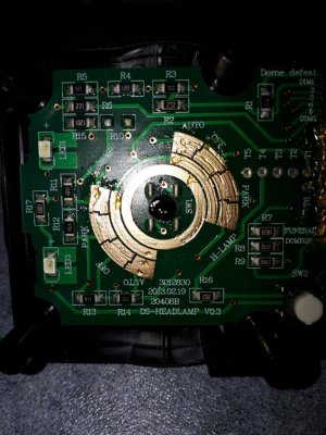

Light switch won't turn off - pic?
I had trouble with my lights staying on after I turned the truck off. And sometimes they would just turn on. Ended up being the circuit board in my headlight switch. Where the switch contact rubs on what you select wether auto, off, parking, or headlights had bridged the contact on the circuit board. Took my knife and scratched away the bridges metal on the circuit board and the headlights work as intended. I have pics if needed.

I had the same problem with my 2014 bare bones truck(no fancy options). I thought the problem may be in the switch and I was going to replace it but thought if I wreck the switch trying to fix it then no loss. upon opening the switch, I noticed that between the light contacts labeled Auto, Off, Park and H-Lamp there was a small metallic strip bridging the metal contacts right where the fingers from the selector knob rubbed across the contacts. It did not look like it was supposed to be there and it did not make sense for these to be connected at all.
Symptoms:
- Turned truck off and headlights remained on.
- when lights off position was selected lights remained on and they should turn off.
- when fog lamps were selected headlamps stayed on when they should turn off.
- key in ignition warning came on when keys were out of the ignition
Cause:
Light switch circuit board contacts became bridged with metallic residue possibly from switch contacts wearing off and collecting between the four contacts or possibly overheating.
Solution:
- remove light switch
- remove 4 screws from back of light switch
- remove metallic bridges between switch contacts by scraping the area between the contacts( see photos of before, knife used to remove bridging and after)
Effect:
-Lights turned off again after turning the truck off(of course I had to wait for the time delay which can be set at different intervals.
- when lights off position was selected the headlamps turned off as they should.
- When parking (fog)lamps were selected the headlamps did not come on so they operated correctly.
- key in ignition warning did not come on when keys were removed from ignition.
Analysis: I could have bought a new switch but hear that they are prone to the same problem occurring so I thought I would extend the life of the original switch by trying this fix. Hope this helps!
