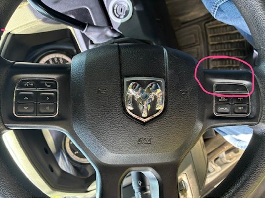

Feb 17, 2023
6
75844
diesel
This may just be coincidence, but my cruise worked when it felt like t. My husband was driving, got irritated and pushed the empty "button" above the on/off, and it started working! Later it wouldn't work, he pushed same and started working. Hope this helps!
