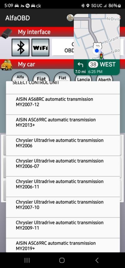

Hey everyone, I'm trying to perform the transmission quick learn on my 2015 Ram 2500 2WD with the 66RFE transmission using AlfaOBD, but I can't seem to find the option. I’ve watched a few YouTube videos that show it, but when I go through the app, I don’t see it. Maybe I’m looking in the wrong place or missing a step? Any guidance or suggestions would be really appreciated!

Mine lists on my 2018 in Alfa as "RFE Quicklearn"
What module are you looking through?

I went for the transmission one I think I went to the body control too but I didn't see it I'll be sure to take a quick look again when I get back

Those look like modules for Aisin? Not sure on the gas trucks if thats the right module? I have a heavy duty so mines the 68RFE
If I recall correct, it should be in the engine module not the transmission- because that is where I also find the run lift pump procedure when I change fuel filters
