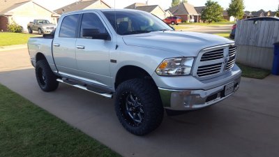

small
Stick with the regular shocks, they are awesome, don't see the need to upgrade to Fox, IMHO.
