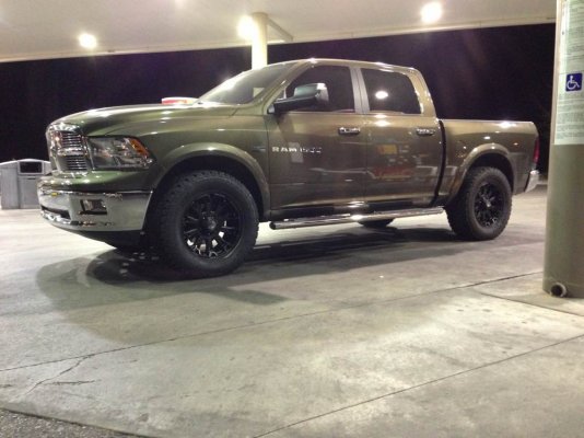

Here's my 1500 with 20x9 +0 offset with a 35x1250 and just a level. It's now lifted 4" but it ran just fine with zero rubbing with a pro comp 2.5" leveling spacer.
