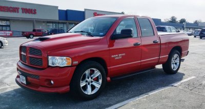

The pics above are of my old 2003 Ram...I installed the 20"s of a 4th gen on it using the stock lugs...fit like a champ!

Well, I already bought mine before I got a response on this thread, and soon after threw my back out... finally able to bend/move and a sunny day so just slapped the first one one.
Looks good... but may need to eBay new lugs. Originals are pretty beat up and rusting, guess someone used the wrong size socket or something.
I'll have to take a pic when done... looks good. In a few weeks I have to spring for new brakes... may photo after that... just because will look nicer. :D
I got black ones off a 2018 Ram 1500 Classic. 10,000km on them with those mediocre Wrangler SR-A stock tires. Still... paid less than a set of new tires installed, plus my old rims looked bad. Previous guy spray painted with Tremclad I think and half flaked off. Will just sell them cheap and make my upgrade even cheaper overall. Debating keep for winter... but I usually just get all-season and leave it at that.
