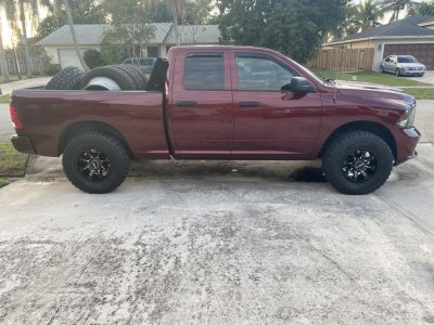

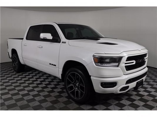

I I through in a pic of my current cummins and an example of what truck I'm looking at.1ec022e70fcf4aa3897b0a87b92dac9c.jpg99f55f71f92f092621323cbcd4633917.jpg33583051c695374f6634af298e4d46ae.jpga5b092e9298170ddcfe817e63c20a556.jpg

The new 19s need 20” rims. Only certain 18s will fit due to the oversized brake package they come with. I have the previous still truck, A 2017 with 18s and 35s on a 3” lift and no rubbing. 4” with 35s should be good for you.
