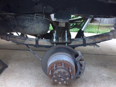

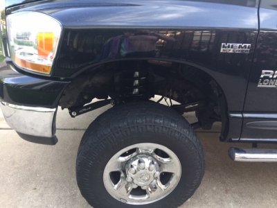

Just installed the Carli 3' Starter System. Love it! Did the install by myself at home in the driveway with basic toolsView attachment 206116 View attachment 206117 View attachment 206118 so no need to pay someone to do it. Included the front springs and shocks, torsion sway bar, upper and lower extended control arms and trackbar in front plus the add a pack leafs and springs in the back. Much better ride. Also installed Nitto ridge Grapplers 35x12.5r17 on XD 829 Hoss 2 wheels.View attachment 206119truck.jpg Carli Front Suspension.jpg Carli Rear Add A Pack and Shocks.jpg
